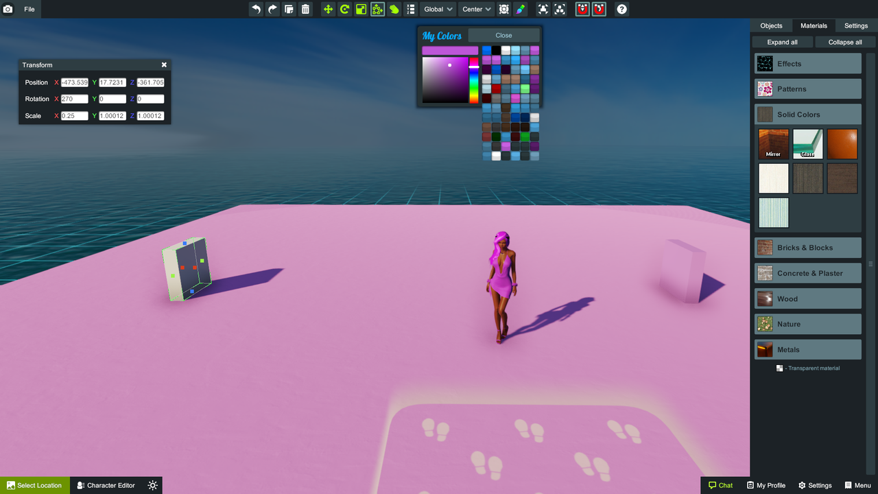

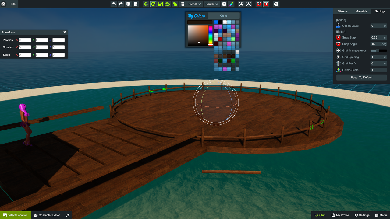

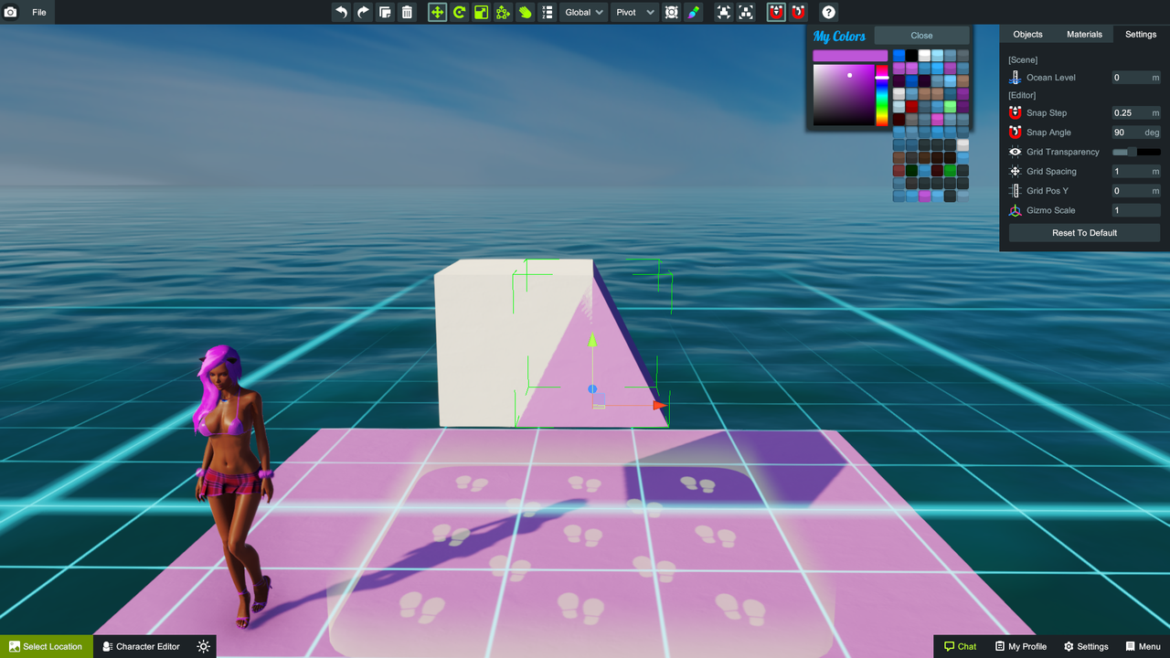

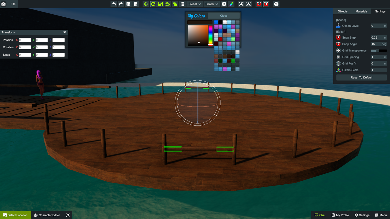

Aliviax Posted February 2, 2019 Posted February 2, 2019 (edited) Hi everyone This thread is about build tricks that I will share for faster build some may know some not so this thread is for those that dont here is my first As u can see in the pic u have made a round platform and u wanna dress it with bars so u cant fall in water . you have put some initial bars arround the platform n now u want to make some horizontal ones . well the only thing u have to do is make only 2 of them in opposite direction ,then group those 2 .now since i made those vertical bars with 15 angle rotation ill use same angle for the horizontal and first ill copy and then ill start make new ones in perfect place i will keep copy n rotate in 15 deegre angle then ill delete spare ones n we good to go u now perfectly have dressed the bars its only a matter of few seconds stay tuned for next build trick muack Edited October 23, 2019 by Aliviax Alliehotass, Anong, MeiLing and 6 others 9

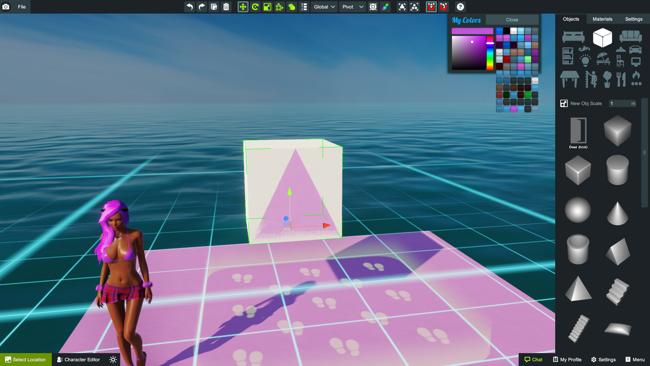

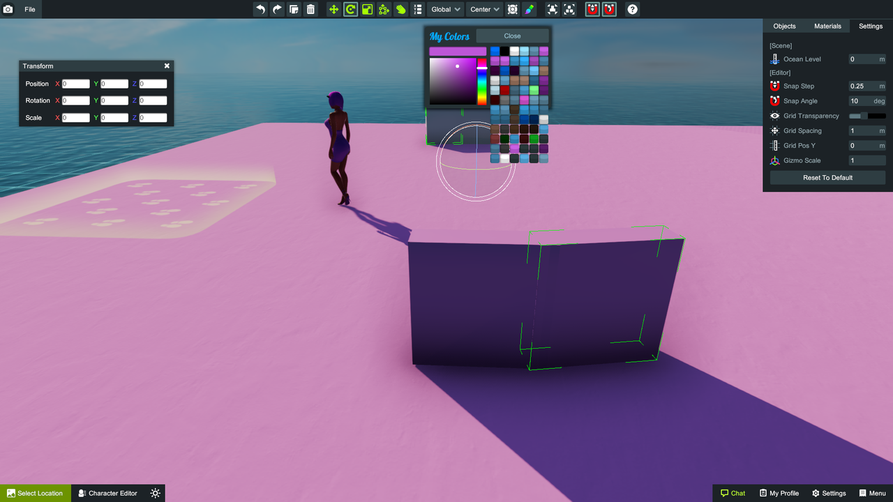

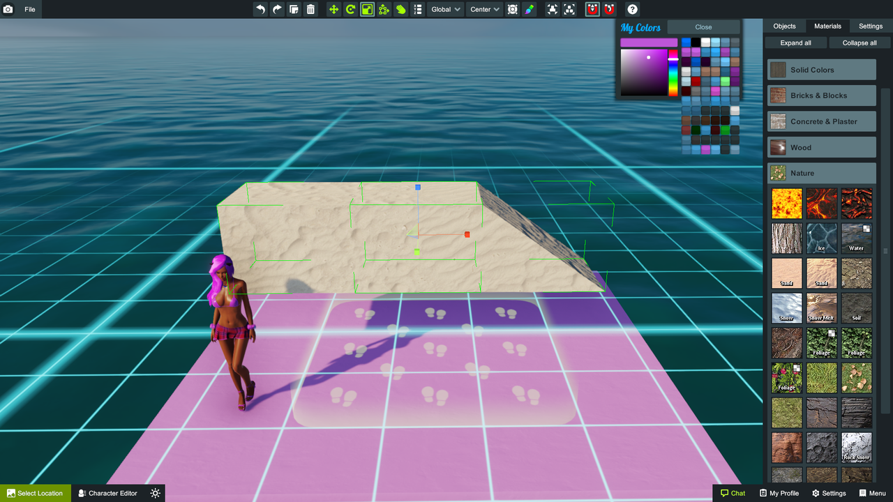

Aliviax Posted February 3, 2019 Author Posted February 3, 2019 (edited) Lets say u want to make a cool beach n a terain with a nice angle leading to water we set values 0.25 for snap step n select the left magnet that is for snap step then 1st we select a square n then the triangle exactly inside the square .(u can achieve that by selecting the props u want without move ur camera so both props drop in same spot ) since both props are in the same spot u move by 0.25 the latest prop u placed and they conect perfectly (this save u lots of time of fine tune props to be in same place ) u turn both props into sand and group them then having picked both u start enlarge them with the tool i have selected on the pic that will follow keep enlarge from both sides and in a matters of seconds u will have this perfect beach terain muacks Edited October 23, 2019 by Aliviax Rodin, EagerHank, panCDCA and 3 others 6

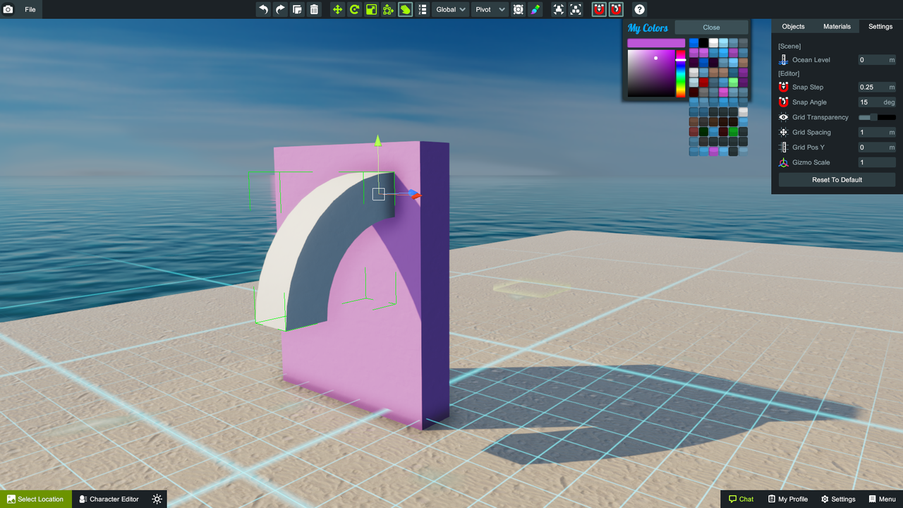

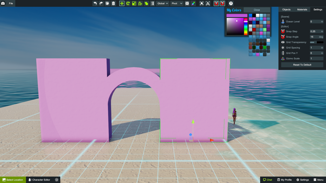

Aliviax Posted February 3, 2019 Author Posted February 3, 2019 making a dome with new props 1st u set value for snap Angle on 90 degreeand also select the snap angle (magnet tool) also important is that for this one we set to PIVOT n not center i pic ur prop then ctrl+D for place another copy n rotate 1 time on 90 preselected degreekeep copy n rotate then u group it -selct it n paint it a color n a texture u like Anong, RebekahKramer, Alliehotass and 2 others 5

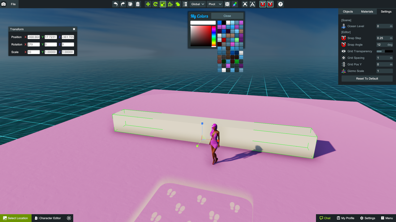

Aliviax Posted February 3, 2019 Author Posted February 3, 2019 lets say you already have a wall build and u want to make a gate( i have noticed many rooms arent perfectly connected cause ppl drop props randomly n then they try fine tune them to fit perfect but most cases they dont ^^ ) here is a quick tip/trick to make it perfect here is our pink wall n we try connect perfectly that white gate(prop)that white prop is 2 propsanyway not important . so how we will conect it perfectly ... 1st we choose the white prop that u will see in the pic bellow then we select the hand tool n place the prop in the wall... we rotate the prop at 90 degrees angle using Pivot then we movethe prop at the 0.25 snap step that we have selected and we have a perfect match now i wanna mention something important when u start build its imperative to use snap step from the start of the build so all ur walls be same so they can be matched later perfectly but if u start drop props n random values u will come to loose it n nothing will fit n connect nice . anyway i copied the prop rotated and make this gate and continued my wall muacks RebekahKramer, Rodin, Anong and 4 others 7

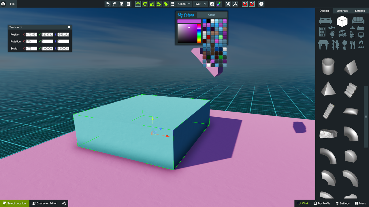

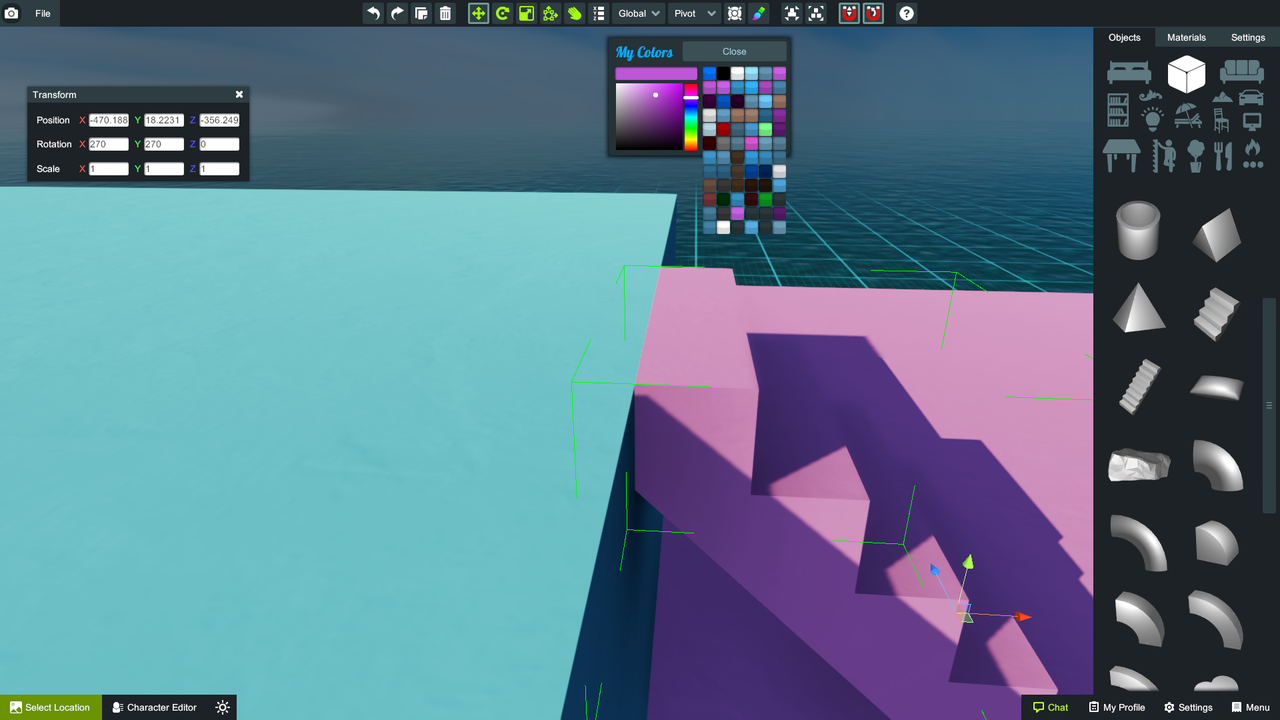

Aliviax Posted February 26, 2019 Author Posted February 26, 2019 Lets move to more advance tools here i talk about the trasnform tool so u wanna connect some stairs perfectly (see pic bellow)in this situation we try connect those stairs in the blue wall so u can go up there but we want a perfect match -1st important whenever u start a build u always have set snap values so what we wanna do here is open the trasnform tool and we gonna copy/paste the blue Y value to the stairs (Y) stands for hight so i select blue wall -go to trasnfor tool copy the Y value then click the stairs n paste that valueand stairs go down like pic bellow Now since i had set snap values from start on 0.25 snap step and knowing blue wall is 1 i only have to enable the snap step magnet so i every time i move stairs up it will move on 0.25 value move more ... and here we have a perfect match -snap step values +snap step+ transform tool=very powerful combination for a clean perfect building muacks Anong, Rodin and Alliehotass 3

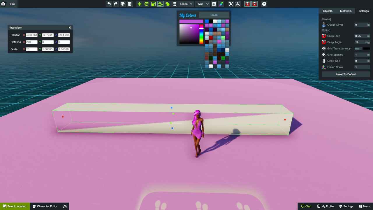

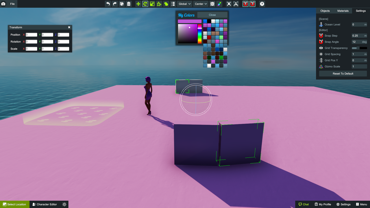

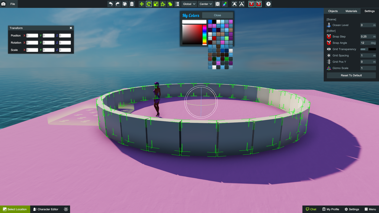

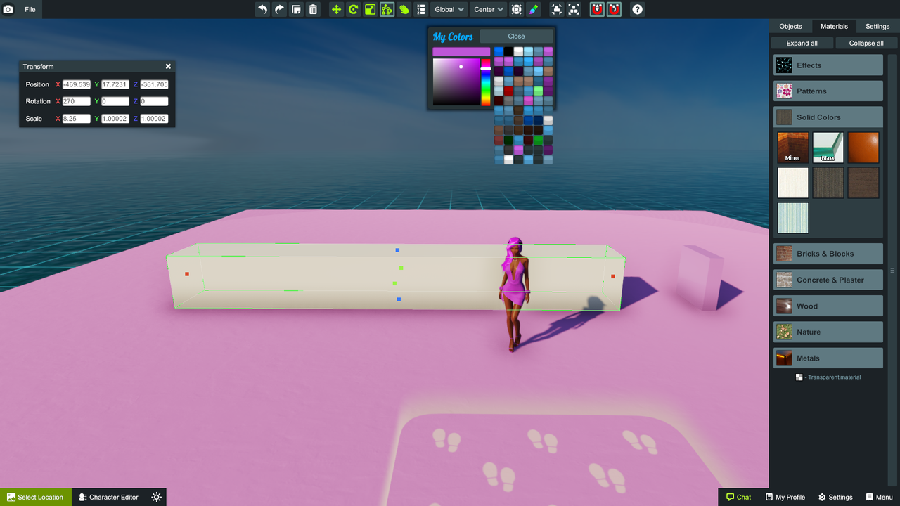

Aliviax Posted February 26, 2019 Author Posted February 26, 2019 Something more advancesay you want to make a round stracture 1st -we always set snap values n select snap magnet we drop a cube n using the trasnform we make that cube 10 for X value ( we gonna create a round stracture of 10 diameter )now after this we gonna copy that stracture n we gonna paint it pink so we can see it ,then using using the tool next to the hand we srink the prop up to 0.25(or how thin we want our wall to be) we do the same for the other prop also then we select both props n group them .after that we will try a angle step value of say..10 degrees see if it works for us and copy the props n rotateas u can see in the pic 10 degrees dont work ok so we will try 12 degrees (what we want is either to conect perfectly or have a lil distance between them ) so to not waste time now fine tuning we we let some small distance ok thats good enough ..now we copy props n keep rotate at the latest angle step value we set 12 degrees keep on .. till we have this n then select all the props after that as u will see in the following picwe pick the tool that we enlarge stuff(check following pic which tool i have pick ) and we choose center for now n we disenable snap step n fine tune all props same time to connect perfect with slow smooth moves then we change from center to pivot mode to enlarge upwards but we also do it by selecting again snap step so we have fixed enlargment and we have our cool round stracture with those simple easy steps muacks Rodin, Anong, MeiLing and 1 other 4
