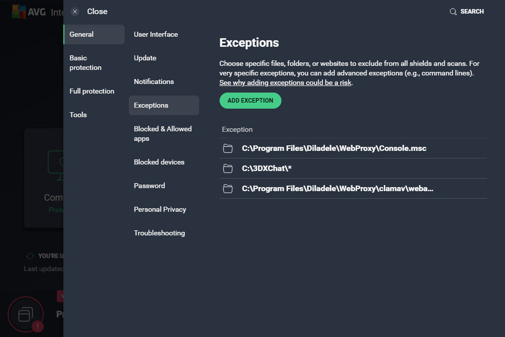

TalisK Posted February 16 Posted February 16 I realise this is an old topic but as a new user I've encountered this issue and use AVG as my AV / Firewall. In AVG Menu > Settings > General > Exceptions I have added the path to the folder when I've installed 3DX, it has autofilled C:\3DXChat\* I guess you could narrow it down to specifically 3DXChat/3DXChat.exe Game/3DXChat.exe Launcher/3DXChat.exe After I added my installation folder to exceptions in AVG it all worked just fine. I guess the same would be true for any other software that may have an exception or equivalent rule. MissD 1
