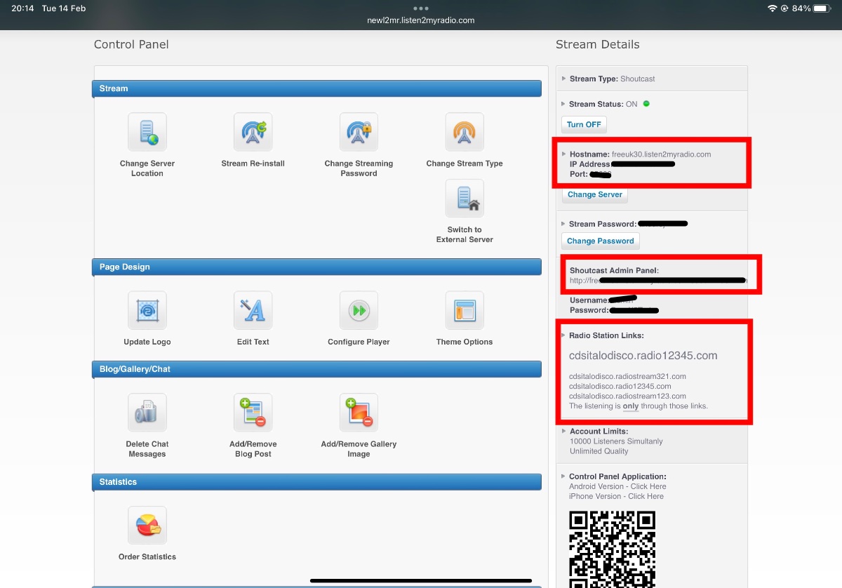

SerenityWillow Posted February 14, 2023 Posted February 14, 2023 I just checked the Url and it is the URL to your online player. That address will not work in the game radio. You need to find the exact address of the streaming server itself. So you need the URL for the shoutcast server, and use that for the radio. A way to tell if you are connecting to the server is put the address in a web browser and the shoutcast server interface should come up. Make sure you format it with the port number as I explained previously. If you can connect to it this way, it will work in 3DXChat radio. The radio functions on HTTP streaming protocol so it works in a web page as well.
Byrkoff Posted February 14, 2023 Posted February 14, 2023 And where to find this address? now im completely lost.
SerenityWillow Posted February 14, 2023 Posted February 14, 2023 26 minutes ago, Byrkoff said: And where to find this address? now im completely lost. The info you are looking for is the first red box. Where it says port at the bottom that you have redacted is the port number. It should look like so: http://freeuk30.listen2myradio.com:PORTNUMBER HERE If it doesn't work try replacing the url with your ip that you have redacted as: http://xxx.xxx.xxx.xxx:PORTNUMBER no one can see your stream address when they connect to your server, but either way is not a security risk as both go to the same place and are public anyway. If it is a secure connection change to HTTPS Byrkoff 1
