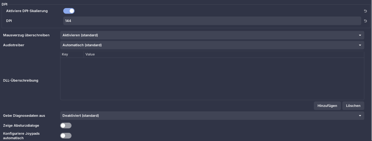

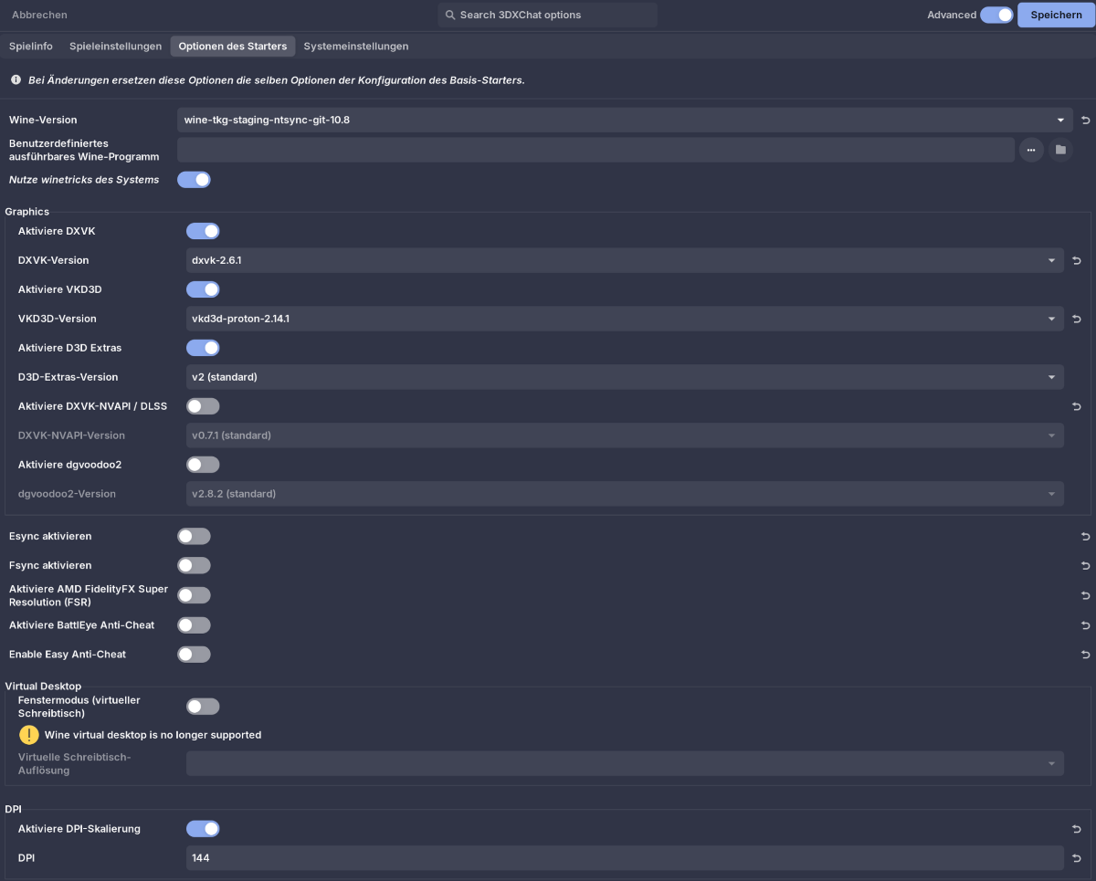

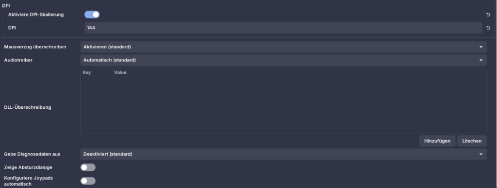

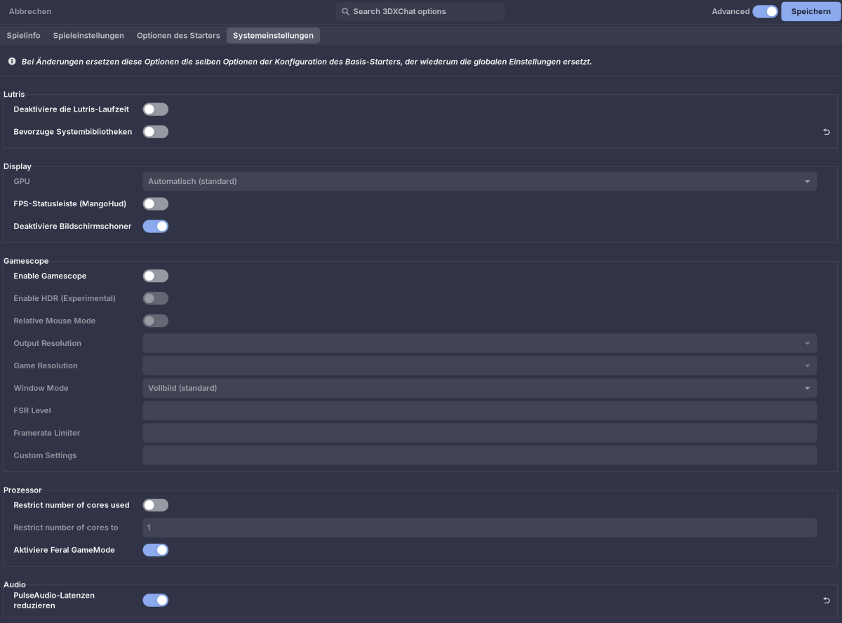

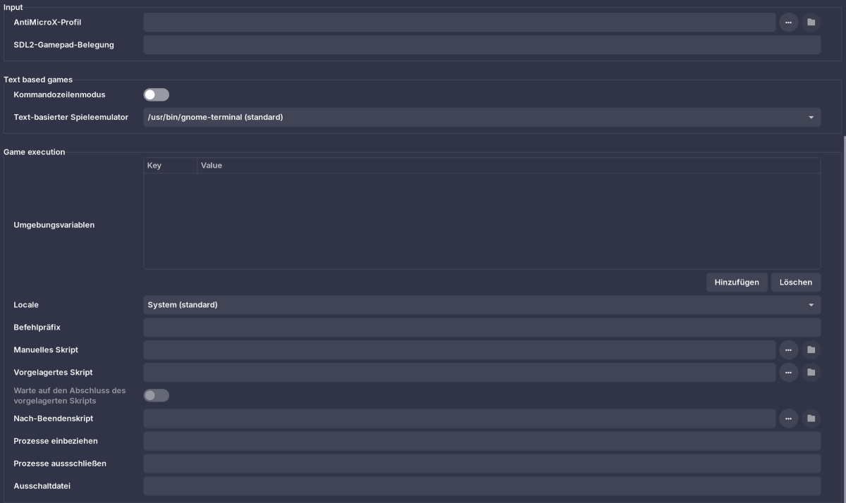

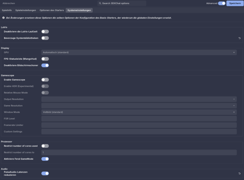

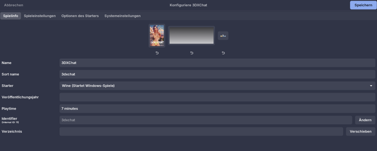

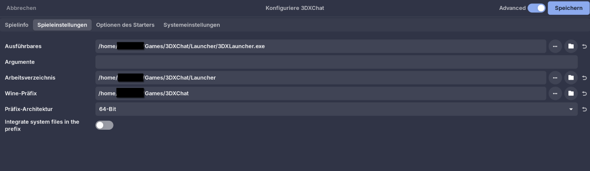

Maybe this info is useful for anybody who wants to run 3DXChat under Linux. I am using CachyOS and I just made screenshots of my Settings in Lutris. With these Settings 3DXChat runs for me under Linux...
I hope someone can use these settings. I installed the wine runner with ProtonPlus for Lutris.
UPDATE: I changed the Wine-Runner to an older Version of kron4ek. This version is much more stable then the 10.8. So, try this one, when you get crashes with the tkg-10.8 runner.
Edited by Solid_Romeo
