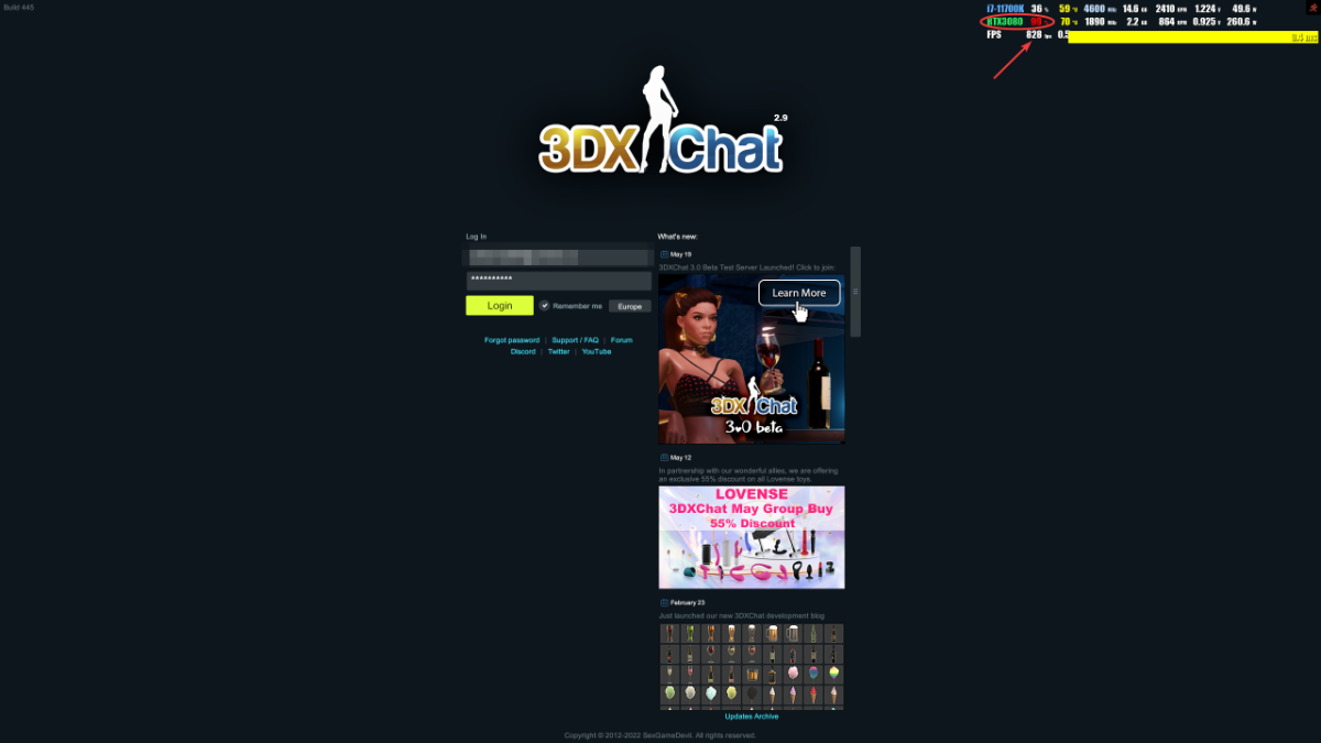

Byrkoff Posted May 23 Share Posted May 23 As title says, i have huge GPU load when 3DX running. On photos you can see more informations and specs of my dektop. Must pointed out that this is only happening on 3DX. GPU Nvidia GeForce RTX3050, 18GB DDR4, Intel I5 9600, SSD Any idea? Link to comment Share on other sites More sharing options...

Byrkoff Posted Thursday at 10:11 AM Author Share Posted Thursday at 10:11 AM Some more informations...i have this load of 96% already at login window...so game not even started. And this is not normal. Link to comment Share on other sites More sharing options...

Byrkoff Posted Thursday at 01:12 PM Author Share Posted Thursday at 01:12 PM (edited) Zabi...it is not normal...game not even starting yet and again...in case you missed my main post: same game runs on 13 years old MacBook Pro with Windows 10 installed at full settings on 60% and at login window 4%. MacBook spec 13 years old: 2.5GHz dual-core Intel Core i5 processor (Turbo Boost up to 3.1GHz) with 3MB L3 cache 16GB of 1600MHz DDR3 memory Intel HD Graphics 4000 SSD Samsung 850Evo 500GB Windows 10 And desktop PC 2 years old: 3.7GHz quad-core Intel Core i5 9600 16GB of 2666&3000 DDR4 Nvidia GeForce RTX 3050 SSD Samsung 860Evo 500GB Windows 10 And here is Intel vs. Nvidia... https://gpu.userbenchmark.com/Compare/Nvidia-RTX-3050-vs-Intel-HD-4000-Mobile-125-GHz/4127vsm7653 PS: i have no problems with running Second Life, which is far more problematic and it runs at full settings on max. 55%... During weekend i will install on another ssd new Windows and 3DX on and see what will be then... Edited Thursday at 01:12 PM by Byrkoff NancyDrew 1 Link to comment Share on other sites More sharing options...

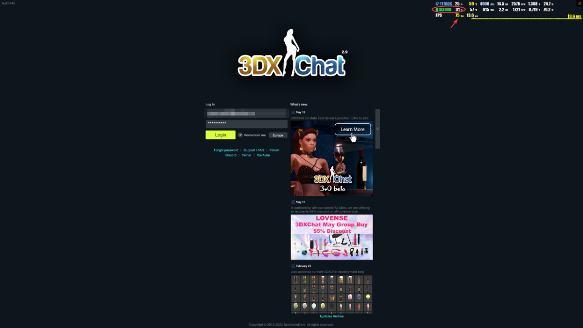

Byrkoff Posted Thursday at 01:38 PM Author Share Posted Thursday at 01:38 PM I must make apology to Xizi who from beginning offered right solution, but i just missed it somehow. It was problem in FPS...i have set to unlimited and in macbook 30. Ichanged it to 75 and now i have 6% at login and 32% in game...and all settings still on max. So again thank to all for trying to help me and to @Xizi owe you are beer or coke Xizi 1 Link to comment Share on other sites More sharing options...
Byrkoff Posted Thursday at 01:41 PM Author Share Posted Thursday at 01:41 PM (edited) yes Tasha...as you see...FPS was problem...damn...:) About Nvidia manager...i don't think i have there some FPS settings. Must say, that i play ocasionally only 3DX and Second Life...no other games at all so at the end, im not much experienced with games. But i use this comp for video editind and 3D modeling...and some renders make computer cpu and gpu fans working quite hard Edited Thursday at 01:45 PM by Byrkoff Link to comment Share on other sites More sharing options...
